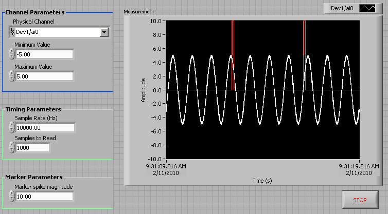

This example allows the user to create markers in the data using a keypress event.
Description
The VI is adapted from the "Cont Acq&Graph Voltage-int clk.vi" DAQmx example.A zero value "marker" waveform is generated and inserted into the DAQmx waveform array. The marker waveform inherits its properties from the waveforms generated by the DAQmx read function, and its chunk size is determined by the "Samples to Read" control, ensuring that it will fit seamlessly alongside the measured data.When the user presses the "Enter" key on the numeric keypad, a "spike" of user-specified magnitude is inserted into the marker waveform, creating a visual marker in the graph. If the data is written to a file, this marker data can be used as a reference in the file, too.

  5. Press "Enter" (on the numeric keypad) to insert a spike in the marker waveform.
