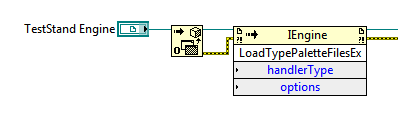

- Call Engine.LoadTypePaletteEx() to load any custom types.

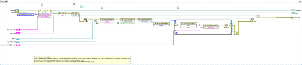

- Create a new LabVIEW step.
- Create the step using the Engine.NewStep() method.
- Access the LabVIEW specific module properties by type casting the Module Object (Step.Module property) to the LabVIEWModule class, using the Variant to Data node.
- Set the LabVIEWModule.VIPath property to the desired VI.
- Call LabVIEWModule.ReloadPrototype() to load the module parameters from the VI.
- To set the parameters, access the LabVIEWModule.LabVIEWParameters collection, which contains an item for each parameter in the VI.
- Set the ValueExpr property for each parameter to the desired property. In this example, the FileGlobals are used here.
- Add the step to the mainSequence of the new sequence file.
- Access the MainSequence using the SequenceFile.GetSequenceByName() method.
- Call Sequence.InsertStep() to add the new step to the sequence.
