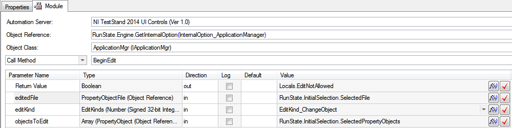

- Before the edit, notify the ApplicationManger control that you are intending to make an edit to a file that it is managing:
ApplicationManager.BeginEdit()
If the file is in a non-editable state, for example it is executing or is read only, the method returns True.
Note: you can access the application manager for the sequence editor using the following engine method:
Engine.GetInternalOption(InternalOption_ApplicationManager)
Since the ApplicationManager class is defined in the TestStand UI control API, you must use an ActiveX step to interact with it; only the core and adapter APIs are available in expressions.

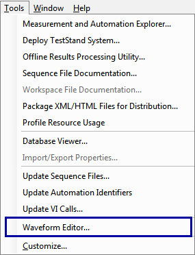

To use the Waveform Editor Tool
- Create a new numeric array property, such as a local, and select it.
- Select the property, then navigate to Tools » Waveform Editor. Note that the tool will be greyed if a numeric array property is not selected.

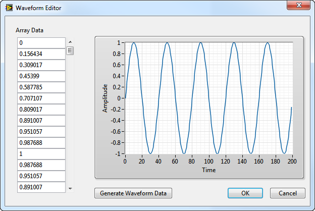

- Edit the array in the dialog, or use the Generate Waveform to create a set of waveform data.
- Click OK, and observe that the array object in TestStand has been updated.
- Undo the operation using Edit » Undo. Observe that the array reverts to the original state.
