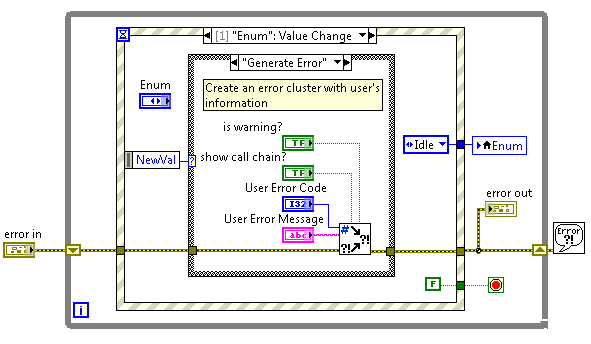

Uses Event Structure to output a user defined error or to clear it.
Description
This example employs the built-in LabVIEW error handling VIs to demonstrate how to inject and/or clear custom user-generated errors in your application. It uses an event structure and state-machine architecture to allow the user to investigate the various components of the Error Cluster from Error Code.vi.
Requirements
LabVIEW 2012 (or compatible)
1. Run the VI.
2. Fill the message and code that you would like to display on the error code.
3. Define if the error cluster will be an error or a warning.
4. Change the Enum to the desired action and watch the error out indicator being updated.
5. Finish the execution with the Stop Button.
