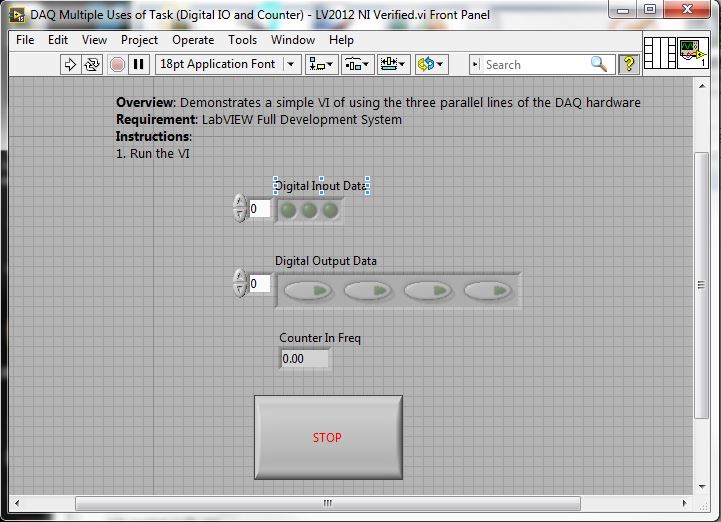

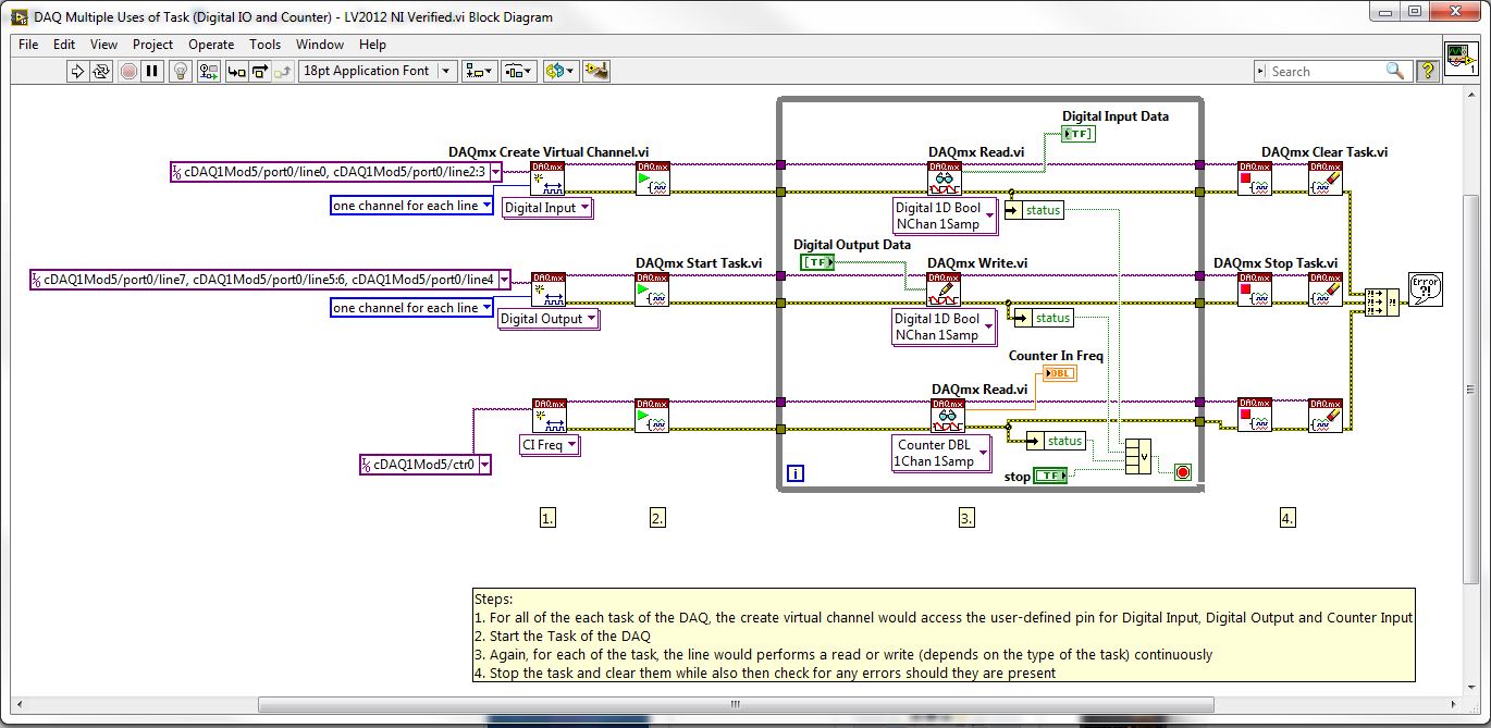

The example shows a simple VI using the three parallel lines of DAQ tasks in a single VI
Description:
This example shows how to set up an application that does several types of DAQmx tasks on one module. This code shows how to set up 4 digital lines for input 3 for output and 1 line for counter input. This example is set up to use the 9401 in Slot 5 of a 9172 compact DAQ chasis, but this code will work form many DAQmx devices

I have been spending the better part of a day trying to get the 9401 to multitask in a 9174 chassis. This VI was very helpful in designing the layout, however, you must reserve each of the tasks before they run or it will throw an error. This is related to the need to briefly reserve all lines for communication of the new line configurations (see section 4-16 of the manual, https://www.ni.com/docs/en-US/bundle/cdaq-9171-9174-9178-features/resource/372838e.pdf)
For testing purposes I've modified this VI to do a counter output so I could feed this back into the digital inputs for viewing the signal. Success!DI-DO-CO.png

 To anyone still working on this, I find that the order in which you start the tasks to also be important. The following seems to work best for me:
Reserve DO -> Reserve Counter -> Start DI -> Start Counter -> Start DO
