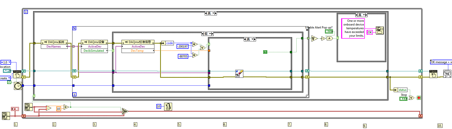

This example works to continually monitor the onboard temperature sensors on the PXI devices in your system..
Description
The purpose of this example is to continually monitor the onboard temperature sensors on the PXI devices in your system.  This Example will read the onboard sensors from supported devices every 10 seconds and log the result to a file.   This example can also optionally cause a pop up dialog box to alert the user if limits are exceeded.

搜狗截图17年01月23日1551_3.png1.  Create or open a TDMS file for saving temperature data.
2.  Set the time betweem temperature checks in seconds (default of 10 seconds).
3.  Get a list of all DAQmx devices in the system.
4.  Check the "DevIsSimulated" property so that you only check the temp on physical devices.
5.  Check the "DevTemp" property to get the temp of each device.
6.  If error -200197 is thrown by the "DevTemp" property then it means that the device does not have a sensor and the results can be ignored.  If error -88705 is thrown by this property then the device is no longer present in the system.
7.  This TDMS write will then write the valid temperature data for all physical devices that have on-board temperature sensors.
8.  Compare the measured temperature with the user defined limits--see the front panel for guidance on setting these limits.
9.  Optionally throw a pop up to the user if temperature limits are exceeded.
10.  Close the TDMS file.
