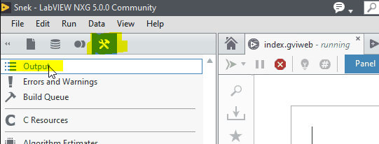

Notes for legacy LabVIEW NXG 5.1 users:
  • The Output pane is opened from the Project Files Pane under Tools Launcher >> Output for LabVIEW NXG
