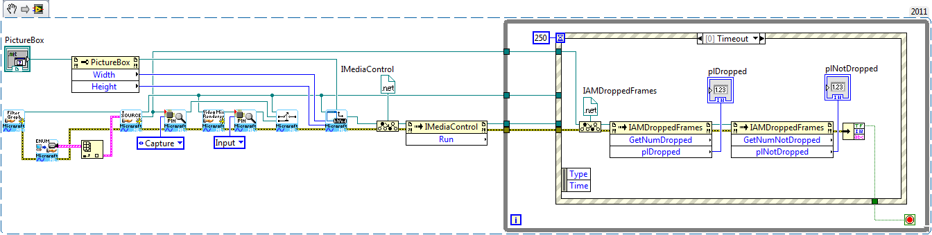

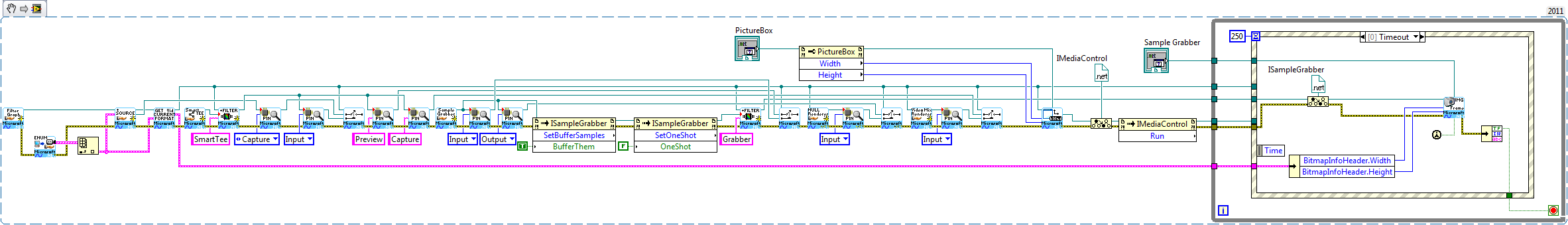

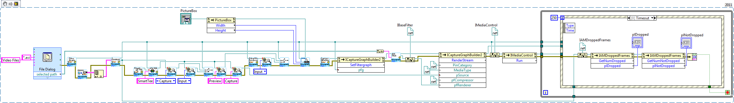

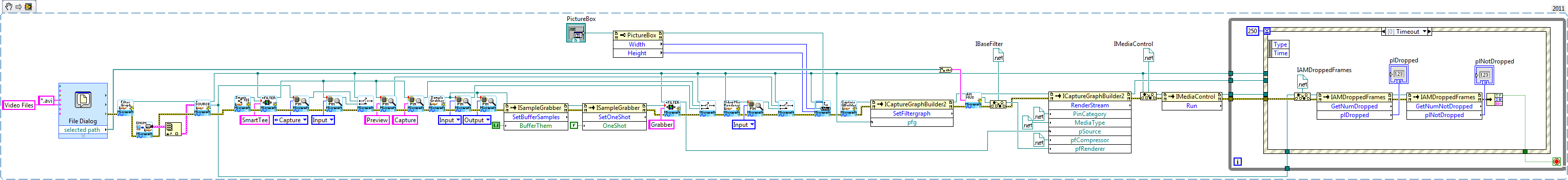

Okay, I was able to get video using GraphEdit (see below) and now I am trying to make the same connections in LabVIEW.
I took the Acquire Video example and inserted a new VI from the AVI Decompressor block (AVI Dec block, diagram below) and changed the renderer from "DirectShow - Create Video Mixing Renderer9.vi" to "DirectShow - Create Video Renderer.vi" but it still doesn't show video.  What am I still missing?

I connected it and ran the VI, went to FilterGraph and the Connect to Remote Graph window doesn't show any remote graphs.

So I registered the dll's for FilterGraph am now able to view more of the properties in FilterGraph and things seem to be working a bit better in FilterGraph, but when I try to connect to a Remote FilterGraph, I see the remote graph, but when I select it I don't see the full chain I'm expecting.

Ok,
Looks like you have pin names mismatched. Try to get pins by name (get actual name from GraphEdit or enum pins) instead of "Capture" or "Input". Also, check if you have any errors adding AVIDecompressor, it should be somewhere on GraphEdit if added properly but not connected.
Note:
You do not need to build entire Filter Graph to see it in GraphEdit, build step-by-step and check how it grows in GraphEdit, while correcting errors (do not forget to clean up, i.e. remove entry after you done with it).
-Artur
