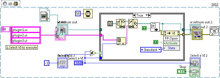

The following VI will allow the user to select pre-defined VIs to run.聽 The user may run one or all of the pre-defined VIs.
Description
In the DisplayMultipleRunningVIs.vi, the Menu Ring controls which VI is opened and run.
The values from the Menu Ring are used to index an array of the defined VIs. (Note:The name of the VI does not need to match the name assigned in the Menu Ring.) The only condition that needs to be met is that the DisplayMultipleRunningVIs.vi is in the same location as the selected VIs, since the Current VI's Filepath VI is being used to define the file paths of the selected VIs. The Load and Run VI and Front Panel Open Invoke Node will display and run the selected VI.
Requirements
  • LabVIEW 2012 (or compatible)
  1. Select the VI that show at front panel
  2. Run this VI
