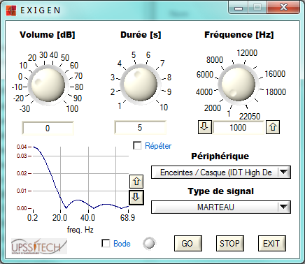

The uir includes controls, mainly:
- a knob for the volume adjustment
- a knob for the signal duration, a button enables its continuous repetition
- a knob for the frequency (or the final frequency in case of a sweep sinus)
- a ring for choosing the output sound board
- a ring for choosing the signal type (sinus, sweep sinus, white noise, hammer)
- a traditional EXIT button
- a STOP button for stopping the running signal
- A GO button for launching the signal generation
- A graph for plotting the FFT modulus of the signal and including two buttons for the display frequency range and a linear/log switch.
DeviceCallback
Callback of the device ring. It stops the running signal, closes the current board and opens the new one.
RunCallback
Sets the signal and displays its FFT
Generates the signal on the output board
StopCallback
Resets the current board
ExitCallback
Exits the program
FreqCallback
The frequency can be adjusted thanks a knob and two button (UP and DOWN) connected to this callback. The output is reset (sound stops).
dBCallback
Changes the volume of the output. Signal goes on.
WtypeCallback
Callback of the signal type ring. Resets the output.
DurationCallback
Callback of the duration knob and the repetition button. Resets the output.
BodeCallback
Switchs between linear and Bode (log-log) FFT display. Acts on the graph
FreqRangeCallback
Set the FFT range frequency.
