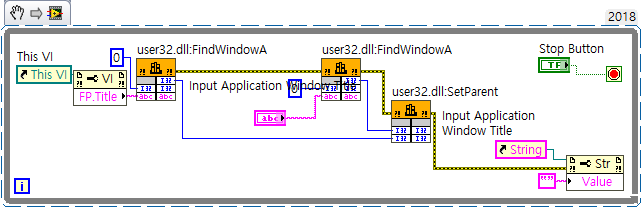

This example demonstrates how to embed a VI or an application on another VI front panel. This example uses Windows API (user32.dll) to get the handle of the VI or application and embed it inside the running VI front panel. The functions being used are FindWindowA function and SetParent function.
How to Use
  1. Type the title name of the desired windows handle of the VI or application into the string control.

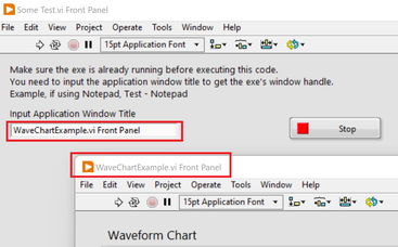

  2. Run the VI.
  3. The VI or application will embedded onto the front panel and can be move freely within the front panel.
