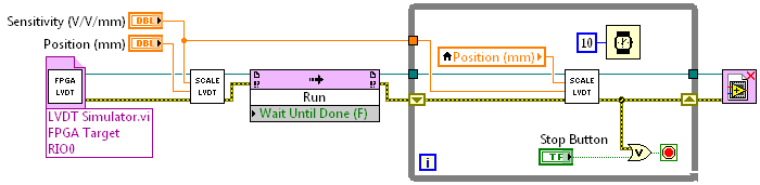

The figure below shows a simple example of using the LVDT emulator in a host application. The LVDT emulator is controlled from a LabVIEW or LabVIEW Real-Time application by initializing the LVDT position and sensitivity variables, running the FPGA VI, and updating the simulated position as needed during the test (shown here within a loop).
Figure 4. Using FPGA-based LVDT Emulator in an Application
