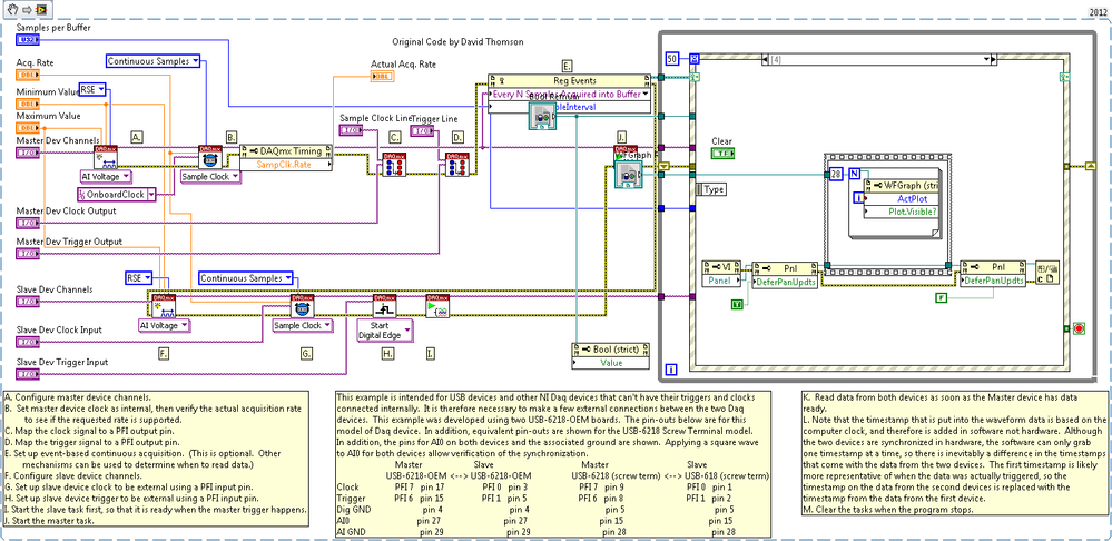

Demonstrate the synchronizing two USB DAQ devices so that they were sampling on the same time scale.
Description
I recently needed to synchronize two USB DAQ devices so that they were sampling on the same time scale.  Although NI has several great resources and examples for synchronizing PCI and PXI devices, for which the clock and trigger signals can be shared via internal signal routing, I could not find any specific examples showing how to synchronize two external DAQ devices.  Building off the NI examples, I could create a program that routed the clock and trigger lines from one USB device out some PFI pins an into PFI pins on the second device.  With the proper configuration calls, connection of several wires from one device to the other, and some juggling of time stamps, I could acquire data from both devices that is synchronized in hardware.

  • LabVIEW 2012 (or compatible)
  • NI-DAQ 12.0 (or compatible)
  • Select the device or physical Channels you pick.
  • Enter the sample parameters such as minimum and maximum value and sample rate.
  • Select the waveforms to display.
  • Run the program
