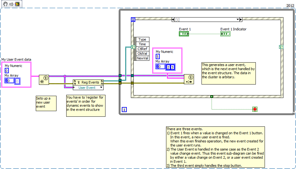

This VI allows you to trigger an event after another event has finished executing, using dynamic events. Specifically, the VI is designed to trigger 'Event 2' after 'Event 1' is triggered, while it is also possible to trigger 'Event 2' separately.
Description
This example utilizes the event structure and its dynamic event registration terminals as well as a user event, to demonstrate a specific situation. Suppose you have a number of events that are handled by an event structure. When you produce a specific event, the appropriate event sub-diagram is run. Suppose that one of your events should always be run after another event. This example gives you a way to automatically fire one event after a different event finishes executing. It also has the advantage of allowing you to still trigger the event by itself as well.
First we register for events, which allows us to add the dynamic event registration terminals to the case structure.When the Event 1 button is pressed, this generates a user event with Generate User Event. After this event has finished operation, this new User Event is triggered and is handled in the same way as 'Event 2 value change' in the case structure.
A single event case handles both the User Event and Event 2 Value Change. Thus the event sub-diagram can be fired by either a value change on Event 2, or a user event created in Event 1.
You can use the user event to pass specific information between the two events: that feature is not included in this example.

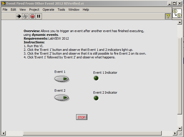

1. Run this VI.
2. Click the 'Event 1' button and observe that Event 1 and 2 indicators light up.
3. Click the 'Event 2' button and observe that it is still possible to fire Event 2 on its own.
4. Click 'Event 1' followed by 'Event 2' and observe what happens.

Front Panel of the VI
Event Fired From Other Event 2012 NIVerified Front Panel.PNGEvent Fired From Other Event 2012 NIVerified Front Panel.PNG
Block Diagram of the VI
Event Fired From Other Event 2012 NIVerified Block Diagram.pngEvent Fired From Other Event 2012 NIVerified Block Diagram.png
