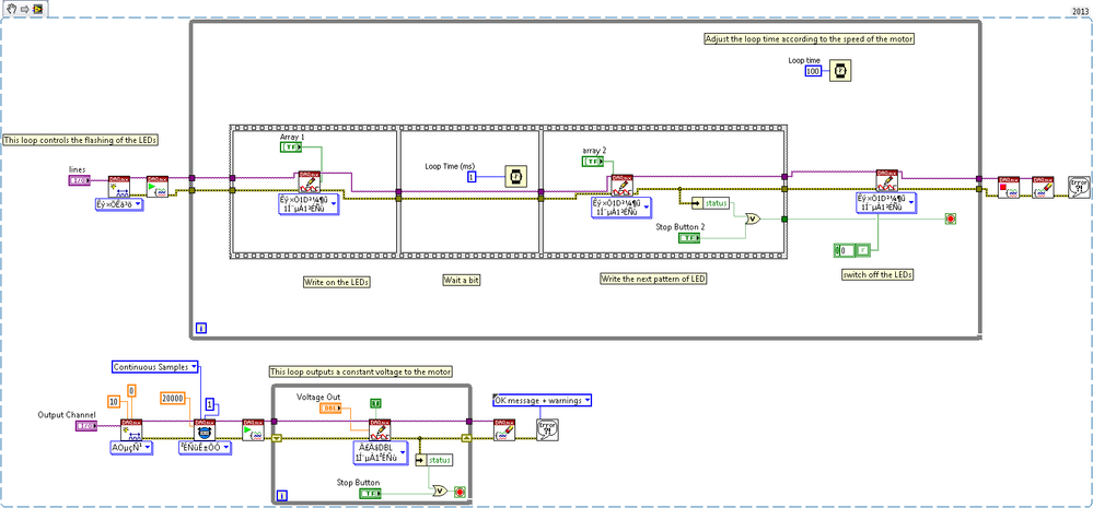

This VI is a template that allows you to control LEDs and at the same time drive a motor.
Description
The first loop in the VI controls the flashing of the LEDs. There is a flat sequence in the first loop with three frames. The first frame writes on the LEDs; the second frame waits and the third frame writes the next pattern of the LED. The Wait time(ms) in the first loop is used to adjust the loop time according to the speed of the motor.
The second loop simply outputs a constant voltage to the motor.
This VI only switches between 2 different states and can hence not display whole letter and must be expanded to display a whole letter.

  1. Know what voltage your fan needs and depending on that you can set the input voltage
  2. Set ports and lines of your hardware.
  3. Set the loop time according to your fan speed and then the code is ready to run.
  4. Extend the code depending on how many letters you would like to display on your LED Fan.
