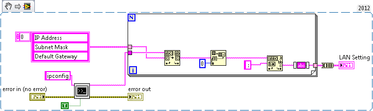

This Example give you the LAN Settings like IP Address, Subnet Mask and Default Gateway.
Description
This example can be used in some project as an subVI to get the IP address, Subnet Mask and the Default Gateway.
Requirements
  • LabVIEW 2012 (or compatible)
  1. Download the attachment to your computer
  2. Open the VI "Get IP Address 2012 NIVerified.vi"
  3. Run the VI
Additional Information or References
VI Snippet

In my Vista system it needs "IPv4 Address" instead "IP Address" in the first string; otherwise it doesn't pick up the main IP address of my computer connected to a mobile internet modem. IPv4 works ok.

This doesn't work if you have a non-English windows installation. You can get a more robust implementation if you use the Windows IP Helper API. Is harder to implement, I know...

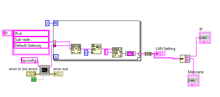

eu usei muito bom , porem como é em portugues tive que alterar cluster
I used very good, but as it is in Portuguese I had to change the cluster
