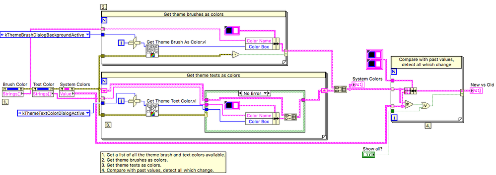

This VI shows what colors change when you change the System Appearance by asking for the theme colors from Mac OS X directly from a system library.
2. Description
These VIs utilize the Call Library Function Node to directly grab all of the information needed from the OS for the different colors. The Call Library Function Node needs necessary input parameters to return the Theme Brush color, the Theme Text color, or a series of system colors from the OS directly which can be seen in the SubVIs included in the Zip folder. Another example which is included in the Zip folder is an example which shows you what system colors change when you change the system appearance.
