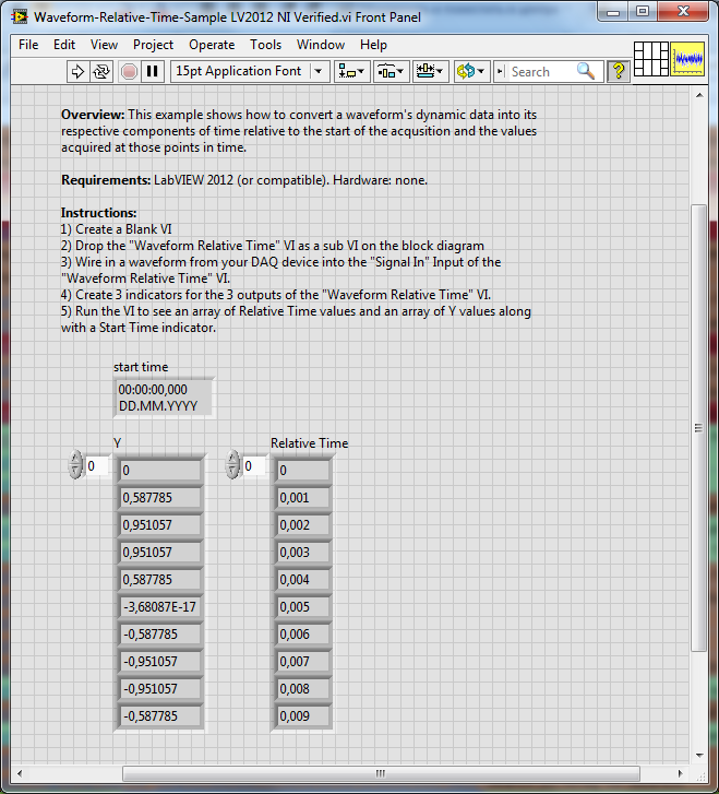

Overview: This example shows how to convert a waveform's dynamic data into its respective components of time relative to the start of the acqusition and the values acquired at those points in time.

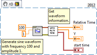

Description: A sample VI is provided with a fixed sine waveform generated with a frequency of 100 Hz and amplitude of 1 and a start time of 0.
Requirements: LabVIEW 2012 (or compatible). Hardware: none.
Steps to Implement or Execute Code:
1) Create a Blank VI
2) Drop the "Waveform Relative Time" VI as a sub VI on the block diagram
3) Wire in a waveform from your DAQ device into the "Signal In" Input of the "Waveform Relative Time" VI.
4) Create 3 indicators for the 3 outputs of the "Waveform Relative Time" VI.
5) Run the VI to see an array of Relative Time values and an array of Y values along with a Start Time indicator.
