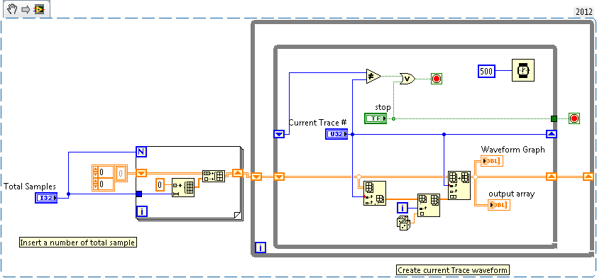

This example utilized a custom buffer which we maintain in a 2d array to graph multiple traces sequentially on one 2d Graph to simulate the effects of a chart.
Description
This example can show the total sample acquire at the waveform graph and also can trace sequentially on 2D Graph to simulate the effect of the a chart..

1.Enter number of traces you will have
  1. Enter total samples for each trace
  2. Run the VI and supply different trace #s as you want to graph different traces.
VI Block Diagram
