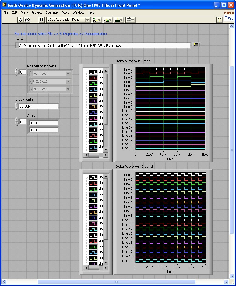

This example shows how to generate synchronized digital data with multiple HSDIO devices using only one HWS File. Specifically, this example shows how to output 40 signals (created in Digital Waveform Editor) to two PXI-655x devices using Tclk for synchronization.
The figure below is the front panel representation of the program. You will have to input a valid file path to the HWS file with 40 signals (attached below). Also, you will need to specify two HSDIO compatible devices with corresponding channels.
