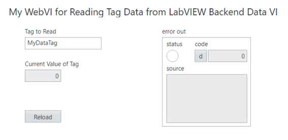

4. Build your WebVI’s front panel, including the indicator we created for the Read Tag function.
You can use the LabVIEW NXG front panel to build a professional-looking webpage without needing to dive into HTML code. Optionally, you can still edit the HTML, in order to embed more complex web code and further customize your webpage.

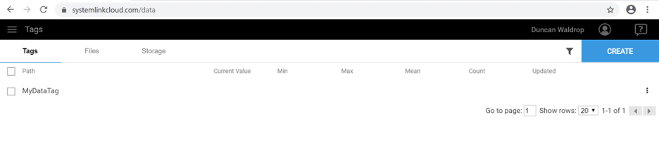

The example code in this series uses a SystemLink Cloud Tag for data transfer to the WebVI, but there are other options for data transfer, such as SystemLink Cloud messages and WebSockets. When we run our WebVI for the first time, a new tag will be automatically created on the SystemLink Cloud. You can also create/view your Tags from the Tags page on the SystemLink Cloud webpage.
