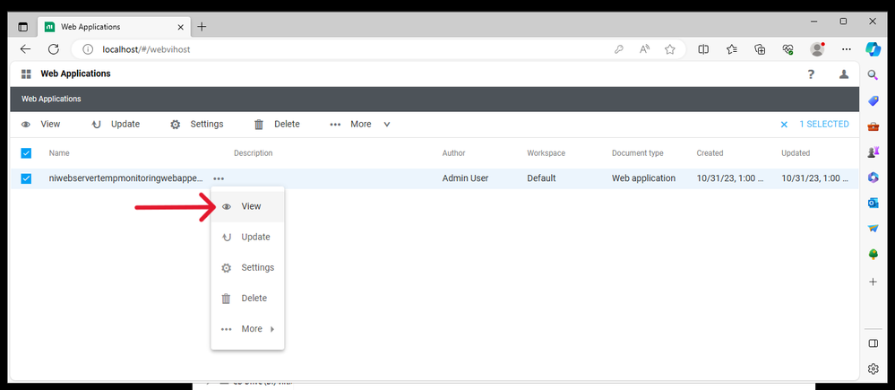

- Open and log into the NI Web Server login page as you did earlier. Go to the Web Applications page and click the Import button.
- Browse to the package file and upload it.
- Your WebVI is now hosted on the NI Web Server.
To view your WebVI, select View from the drop-down menu.
