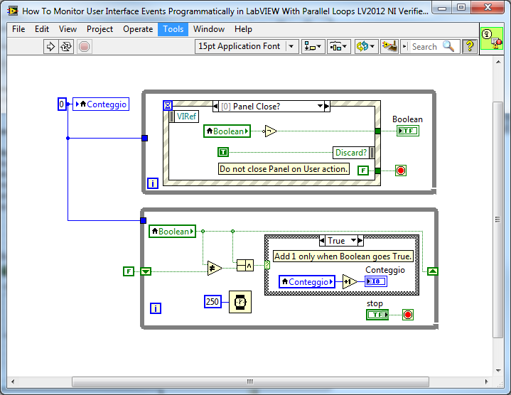

Overview: This simple code suggest a solution to monitor and update program's indicators on events registered on the user interface.
Description:
This simple code suggest a solution to monitor and update program's indicators on events registered on the user interface. Due to the fact Event Structure in LabVIEW freezes the loop structure in which is inserted, it d0esn't allow to use other code inside the same loop. A parallel loop architecture can avoid this situation. The code registers 'resize panel' and 'close panel?' events and counts the number of actions.
Requirements: LabVIEW 2012 (or compatible).

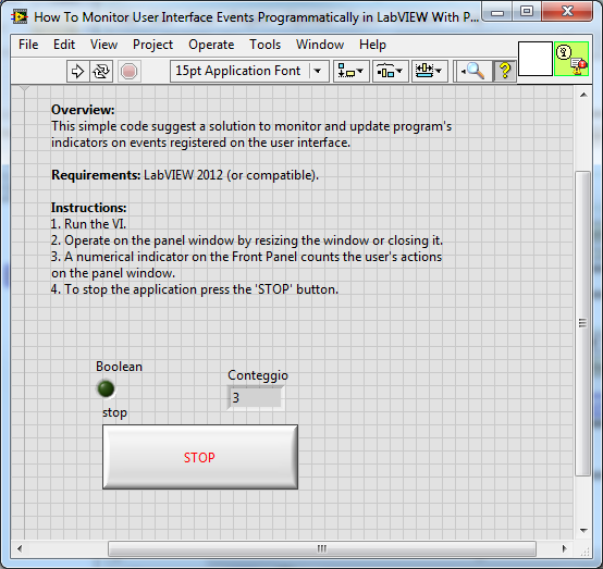

1. Run the VI.
2. Operate on the panel window by resizing the window or closing it.
3. A numerical indicator on the Front Panel counts the user's actions on the panel window.
4. To stop the application press the 'STOP' button.

How To Monitor User Interface Events Programmatically in LabVIEW With Parallel Loops FP.png
How To Monitor User Interface Events Programmatically in LabVIEW With Parallel Loops BD.png
