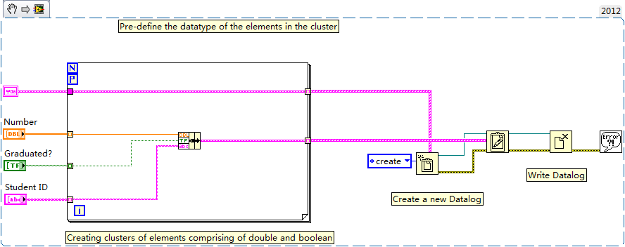

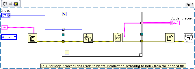

This VI demonstrate the use of Datalog functions to read students' information from a datalog file.
Description
You can use the attached VIs to write different types of information to a datalog file, and read the information by indexing. The read information is split and shown separately which is easy for future processing.

  1. Open the VI "Write to Datalog.vi".
  2. Enter students' information at front panel.
  3. Open the VI ”Read from Datalog.vi”.
  4. Enter Index
  5. Run the VIs

VI Snippet of "Read from Datalog.vi"
VI Snippet of "Write to Datalog.vi"
