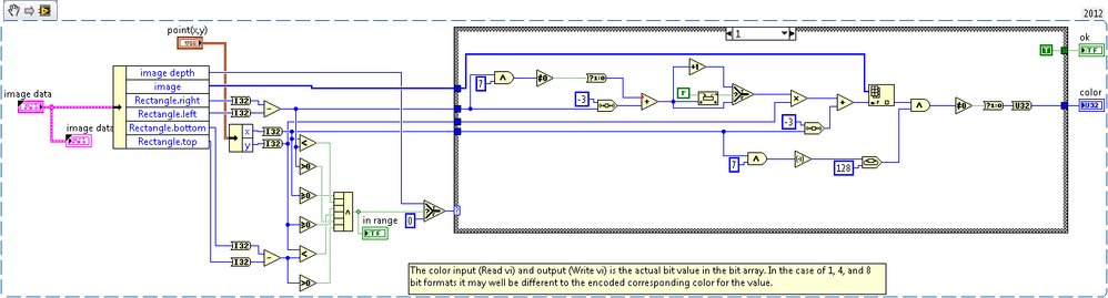

Those two VIs let you read color value and write it directly into an image format.
Description
They accept 1, 4, 8, and 24 bit color formats. Writing to a pixel which is outside the image size has no effect. Reading from outside the image size returns color value 0.
The color input (Read vi) and output (Write vi) is the actual bit value in the bit array. In the case of 1, 4, and 8 bit formats it may well be different to the encoded corresponding color for the value. For example, simetimes 1 bit monochrome image is displays 0s as white pixels and 1s as black ones. These VIs are based on the actual bit values not on colors that are actually displayed. In the case of 24 bit images there is no difference of course.
NOTE: when writing a pixel to 4, 8, and 24 bit formats then any higher order bits are discarded from the the color value. However, when writing to a 1-bit format then there is written value 1 for any input different than 0.
Both VIs return the image that was input (or with changed pixel), there are also 2 boolean values returned: "in range" is true if coordinates were within the image, "ok" is true if processing of the image was performed (coordinates within the image and image bit format belongs to 1, 4, 8 or 24).
The coordinates input is the same bundle of x and y as the one accpeted by Draw Point.vi in the graphics palette.

VI Snippet of "Pixel Read 2012 NIVerified.vi"
