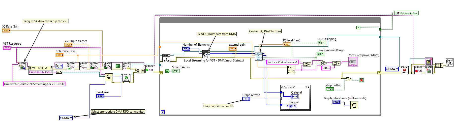

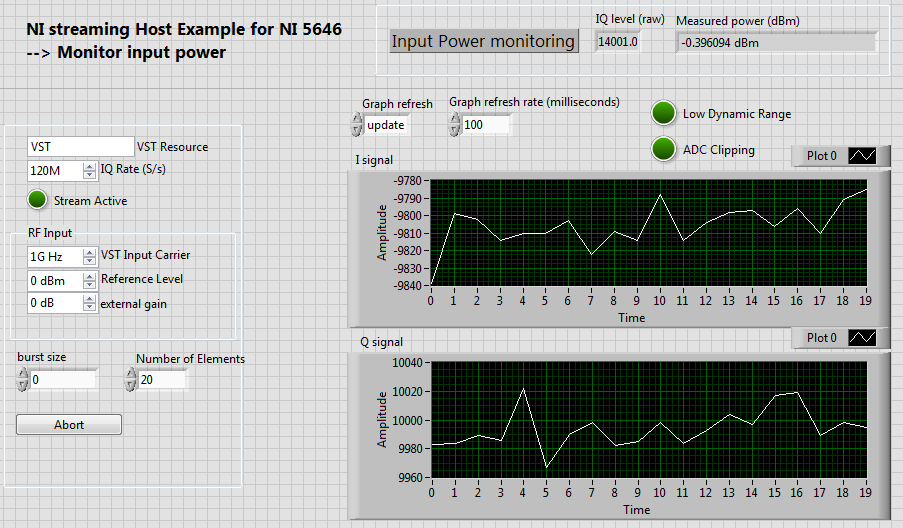

This are the add-on VIs to monitor the input power on Host in the NI Streaming Host Example for NI PXIe-5644R/45R/46R
Description
Three VIs were added from the original reference code to add on functionality to the Streaming Host Example for NI PXIe-5644R/45R/46R
Local Streaming for VST - pass IQ out - Main Analyser.vi (Main VI)
Local Streaming for VST - pass IQ out - Get dBm.vi (subVI)
Local Streaming for VST - DMA input status.vi
