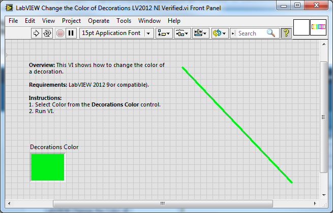

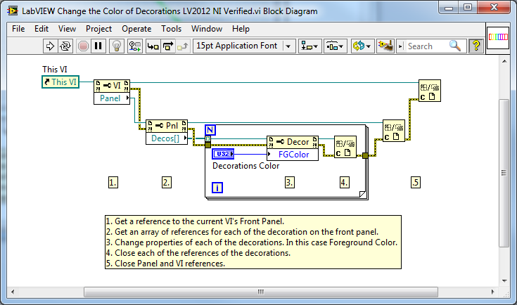

Overview: This VI shows how to change the color of a decoration.
Descriptoion: Changes the color of a decoration in LabVIEW. Knowing how to change the color, any other property can be also change.
Requirements: LabVIEW 2012 9or compatible). Hardware: none.
Steps to Implement or Execute Code:
1. Select Color from the Decorations Color control.
2. Run VI.
Additional Information or References:
