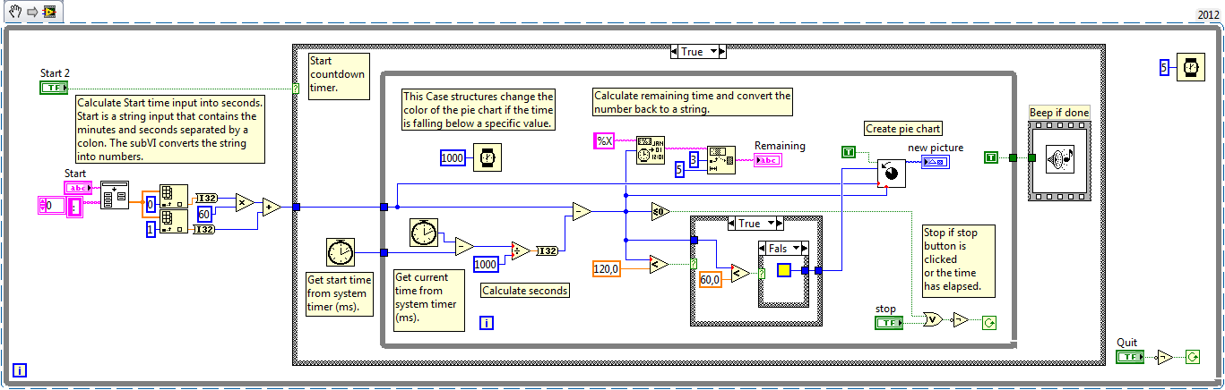

Overview: This is a variable time countdown timer that has a simple Pie Chart to show progress.
Description: This is a variable time countdown timer that has a simple Pie Chart to show progress.
Requirements: LabVIEW 2012 (or compatible). Hardware: none.
Steps to Implement or Execute Code:
1. Run the VI.
2. Set Time set.
3. Click Start.
4. Observe Remaining and Pie chart.
3. Stop stops current timer.
5. Quit stops the VI.
Additional Information or References:
