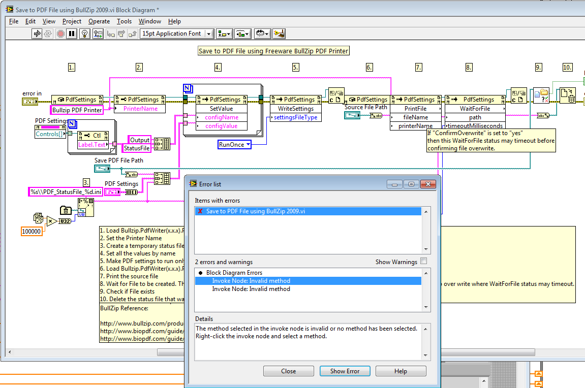

Thanks for the 2009 version. However, I don't understand how to make it run. Labview detects an error, see the image for the details. When I click on show error, it shows the constructor node at step 6, but I'm not sure what to do with it.

Not sure, but just tested here on my PC, it works as expected.
Can you re-download the BullZip and install again?
Or Look for Bullzip.PdfWriter (x.x.x.x) through LabVIEW .net selector?

Yes I did that too, and when I clicked on ok, it changed the code at steps 7 and 8. I'll try reinstalling bullzip

Step 6 select PdfUtil()

Ok I reinstalled bullzip and it worked straight away. Thanks for your help !
