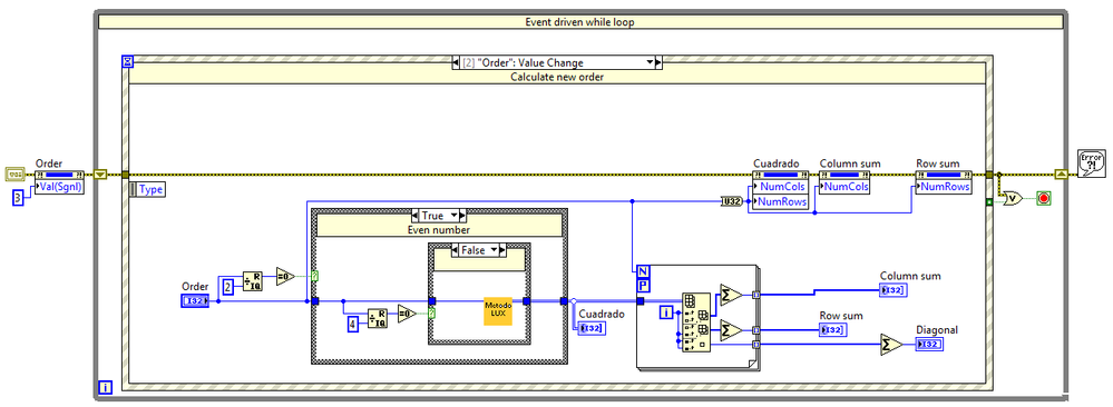

This example generates the magic square of any given order (or size).
2. Description
A magic square is a square array of numbers consisting of the distinct positiveintegers 1, 2, ..., n^2 arranged
such that the sum of the n numbers in anyhorizontal, vertical, or main diagonal line is always the same number.
The Main VI is a program that generates the magic squares of all dimensions. To generate these magic squares, we
develop the three more important methods to generate them. This example shows how to manipulate arrays and how to
switch subVI's based on givenconditions. The three methods togenerate a magic square are:
- De La Loubère's Method.- generates magic squares of odd order, for example: 3, 5, 7, 9, 11…
- X Method.- generates magicsquares of 4*m order, for example: 4, 8, 12, 16, 20…
- LUX Method.- generates magicsquares of order not divisible to 4, for example: 6, 10, 14, 18, 22…
