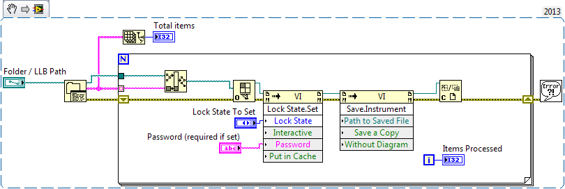

This VI allows you to set the password state of an entire directory or LLB
Description
This VI makes use of property nodes to gain access to the password properties of a VI so that you can set a password, remove a password (provided you know it) and set the VI to locked. Using for loops the code is iterated to allow a folder / LLB to be passed through it.
