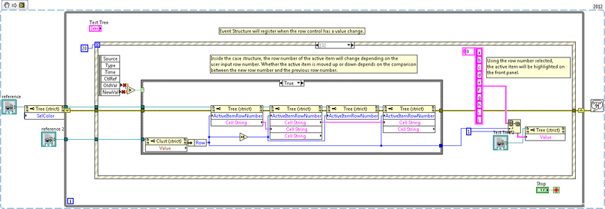

This code shows how to move an active item up and down a tree control by using a numeric control. The active item will also remain highlighted while it is traversing the tree control.
Description
This code uses property nodes to change the row number of an active item in a tree control and to have the active item highlighted when the item is moving in the control.

  1. Specify the row number of item in tree control that you would like to move through the control prior to running the VI.
  2. Run the VI.

VI Block Diagram
