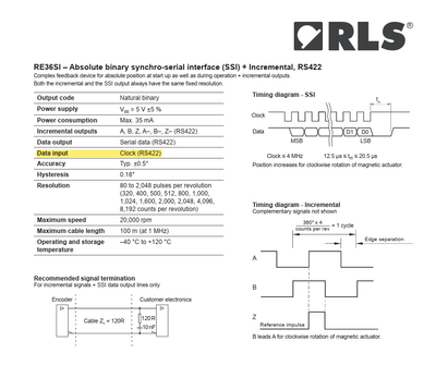

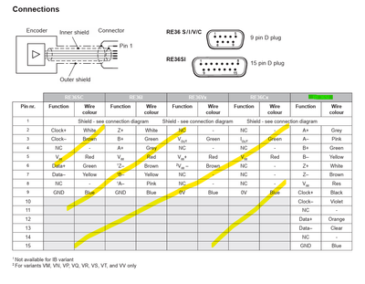

I have NI 9361 module to measure the angular velocity and Angle of rotation using Magnetic Encoder - RE36SI. But I am very new to LabVIEW and not having background in electronics makes it so challenging to design LabVIEW code for this task. Also Do I need to add External power supply to Vsup of NI 9361?
Datasheet of Encoder (RE36SI model) that I am using is attached.
Specs.Specs.RE36SI wires and connectionsRE36SI wires and connections
