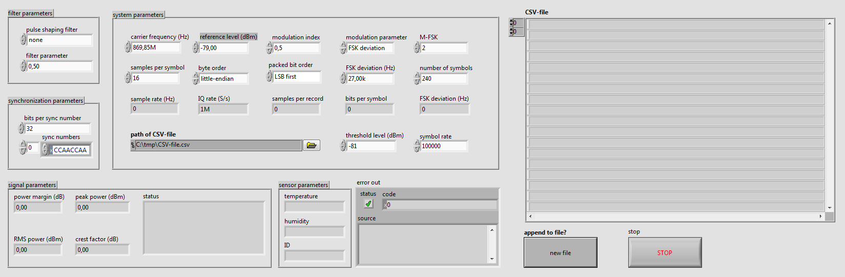

This VI demodulates a M-FSK modulated signal and writes the demodulated bitstream into a CSV-file. The modulation, synchronistion and filter parameters can be defined by the user on the front panel.
Used Hardware: NI PXI-5661.
Used Software: LabVIEW 2013, NI Modulation Toolkit, NI Spectral Measurement Toolkit and the niRFSA Driver VIs.
The following Screenshot shows the frontpanel of the VI.
