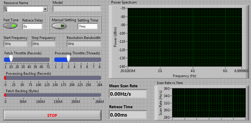

Use this example to perform a spectrum sweep with the NI PXIe-5667. This example shows how to measure the performance of the NI PXIe-5667.
Description
The NI PXIe-5667 is setup for a Configuration List and Advance Trigger, such that each time the Advance Trigger is asserted via Timer Event, the subspectrum for IQ acquisition will change. Note that the configuration parameters that will change for each step are the following: IQ Carrier Frequency, Frequency Settling Time, and Time Interval. Each subspan to be acquired is already hardcoded into the example.
Effectivly, the whole RF signal is acquired in the producer loop in small chunks based on the subspans. The IQ records fetched from the acquisition for each subspan are enqueued with subspan information. The IQ records and information are dequeued in the consumer loop and then converted into a subspectrum. All the subspectrums are concactenated to form the whole frequency spectrum and calculations are made to determine the Scan Rate. The user can determine how fast records are queued or processed.

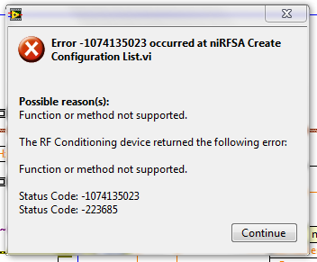

Hi Jason_L1,
I'm trying to run this example using simulated hardware. I configured simulated NI PXIe-5667 (3.6GHz) in MAX. I've replaced the RFSA initialize VI with RFSA initialize with options VI and set the option string to Simulate=1, DriverSetup=Model:5667.
But I couldn't run the VI successfully. Model displayed is NI PXIe-5667 (7GHz) not (3.6GHz) and an error occurred at Create Configuration List VI.
Configuration in MAX:
I don't know if the problem is with option string or simulation configuration in MAX. Could you please help me out?
I thank you in anticipation,
Avinash.
