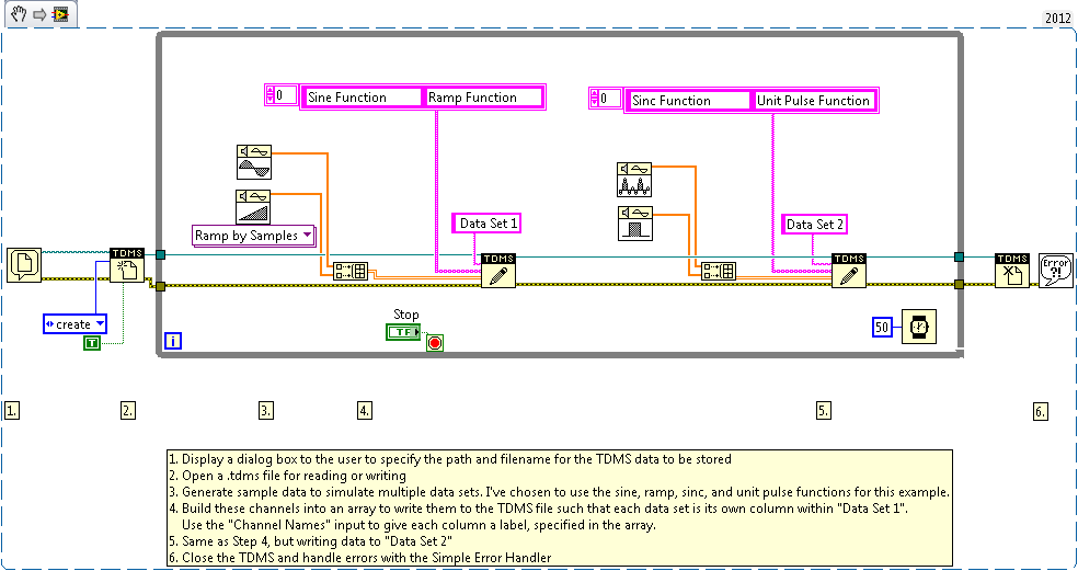

This example is intended to demonstrate how you can better organize data from multiple channels in TDMS.
Description
This VI lets you group related data from multiple channels and write these groups to different worksheets in Excel using TDMS. This example was written in LabVIEW 2012. Simply run the VI, select a file name and location for the file to be saved, and open the resulting TDMS file with Excel.
Requirements
  • LabVIEW 2012 (or compatible)
  1. Download the attached file to your computer
  2. Open the VI "TDMS Multiple Data Set 2012 NIVerified.vi"
  3. Run the program
Additional Information or References
VI Snippet
