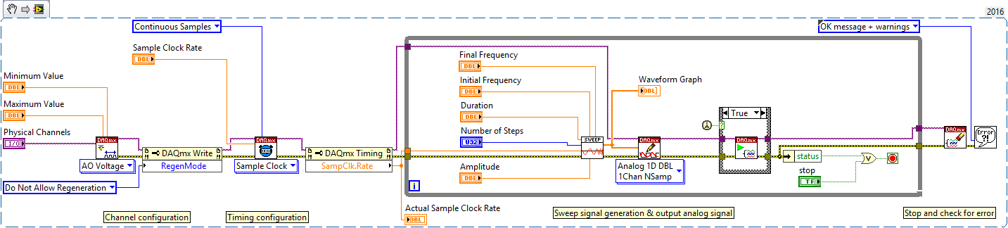

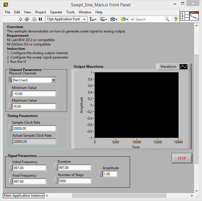

This example demonstrates on how to generate sweep signal to analog output.
Description:
Configure the analog output channel and the swept signal characteristic that you need and this VI will continuously output a swept sine wave in DAQmx.
Requirement:
NI LabVIEW 2012 or compatible
NI DAQmx 9.0 or compatible
Steps to Implement or Execute Code:
  1. Configure the Analog output channel
  2. Configure the sweep signal parameter
  3. Run the VI
