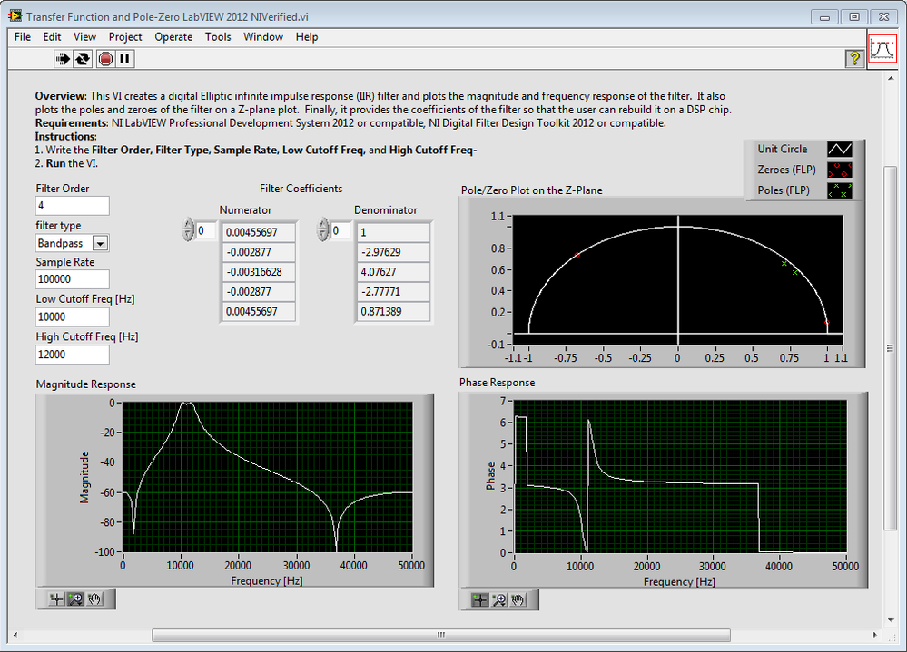

This VI creates a digital Elliptic infinite impulse response (IIR) filter and plots the magnitude and frequency response of the filter. It also plots the poles and zeroes of the filter on a Z-plane plot. Finally, it provides the coefficients of the filter so that the user can rebuild it on a DSP chip.
2. Description
Create your digital filter by choosing the sample rate, cutoff frequencies, filter type, and filter order. A different filter can be implemented by replacing the DFD Elliptic Design VI with another filter design from the Advanced IIR Filter Design Pallete.

4. Steps to Implement or Execute Code
  1. Download and open the example VI.
  2. Write the Filter Order, Filter Type, Sample Rate, Low Cutoff Freq, and High Cutoff Freq.
  3. Run the VI.
