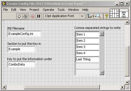

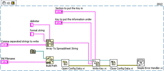

The Config File VIs palette offers an encapsulated way to read and write to standard INI files. First we will generate a config file to use with these functions. This VI is an example of how this can be done. First it opens up the config file, converts the string array to a single string, writes the data to a specified key, and closes the file.
If you open up the INI file in notepad you see this information.

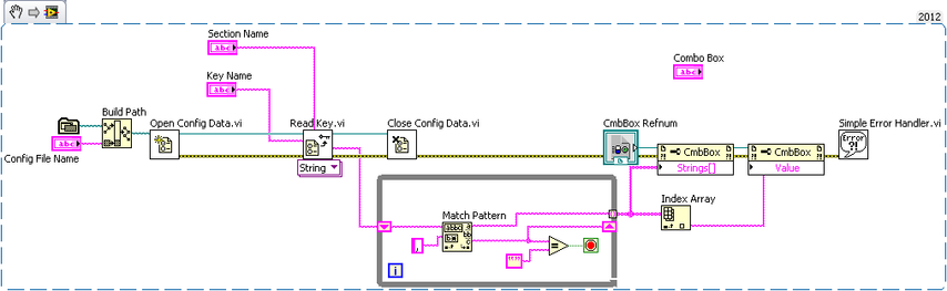

Now that we have a config file we will use it to populate the values of a Combo Box programmatically. To do this we open the config file, read the data at the correct location, parse the string into an array, write the array to the Strings[] property of the Combo Box, and set the value of the combo box to the first item in the array.

  2. Open and run the "Create Config File.vi" (change values if you want)
  3. Observe how the INI file was created in the folder that the VI executed from.
  4. Open and run the "Populate Combo Box.vi"
  5. Observe how the Combo Box is filled with the information from the INI file.
