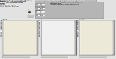

The example demonstrates how to create a polygon Region of Interest (ROI) programmatically.
Description
The example shows how to programmatically create an image that is not necessarily rectangle-shaped.
By default, images are always rectangle-shaped. To work around this one can create a mask from a Region of Interest (ROI) that is applied onto the image to apply non-rectangle image shapes.
The example provides to possibility to define any ROI type programmatically that is later used to mask the image to the desired shape.

  1. Open the attached file
  2. Run the VI
  3. Select the type of ROI with the tab control
  4. Configure the settings for the respective ROI type
