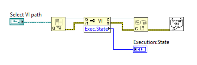

This VI demonstrates how to programmatically determine if a sub-VI or VI is running on your computer.
Requirement
LabVIEW Full Development System 2012 or compatible
  1. Enter the path of the VI to determine its status
  2. Run the VI, The VI will return the following Execution States:
    Bad—VI has errors and cannot execute or VI is not currently running
    Idle—VI is not running, but is in memory.
    Run top level—VI is the top-level VI in an active hierarchy.
    Running—VI is reserved for execution by one or more active top-level VIs.
Additional Information or References
VI Block Diagram
