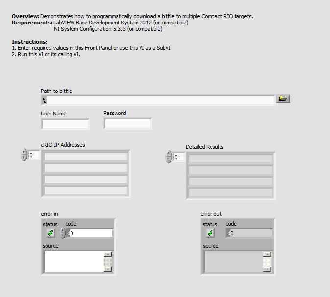

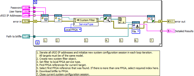

This example demonstrates how to programmatically download a bitfile to multiple Compact RIO targets.
Description
It is possible to programmatically automate the process of downloading FPGA bitfiles to the flash by using the System Configuration API. The next LabVIEW VI is an example that shows how to automate the process of downloading the same bitfile to several CompactRIO targets which are referenced through their IP Addresses.
If you would like your FPGA application to run automatically at boot, please also ensure that the source VI was compiled with the Run when loaded to FPGA property set. For more details please refer to the KnowledgeBase 4P7IJ4MO: How Can I Have My FPGA VI Run At Boot?
In all the cases the FPGA targets where the bitfile is being downloaded have to be the same since the compiled bitfile is hardware specific. The corresponding drivers for the hardware being used must also be installed on the local computer for these examples to work. The LabVIEW FPGA module is not needed. The VI can also be compiled into an executable and run with only LabVIEW Runtime and CompactRIO Runtime installed.

  1. Download and open the attached file "Programmatically download Bitfile to cRIO LV2012 NIVerified.vi"
  2. Open VI and follow the instructions in Front Panel and Block Diagram and run the program.
