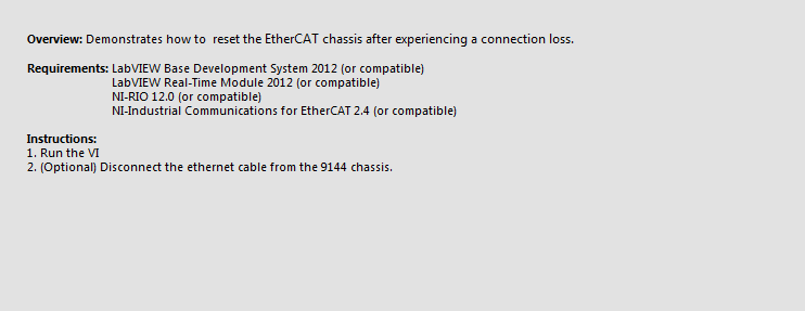

This example demonstrates how to  reset the EtherCAT chassis after experiencing a connection loss.

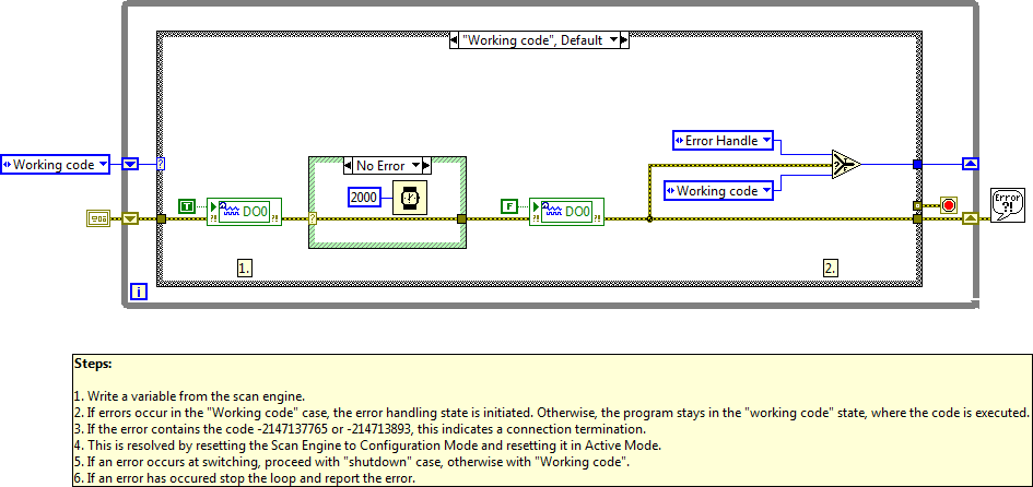

This is an example EtherCAT project to show how you can reset the EtherCAT chassis after experiencing a connection error.
If you have a C-Series module anywhere in your code and you loose connection to your EtherCAT chassis it will result in your code throwing an error and aborting. With the right error handling, this can be prevented.
This code shows, using a simple state machine, and how adding error handling into your code can help you and prevent you from loosing data if your system is for example being run overnight and is not monitored.
The error will still be reported and can be seen later in the Distributed systems manager and can be seen in this image below.
This attached code will reset the EtherCAT chassis by changing it programmatically between active and configuration mode just like you can do by using the "Change to Configuration" button as seen in the image above.

  1. Run the VI.
  2. (Optional) Disconnect the ethernet cable from the 9144 chassis and view the execution in debugging mode.

 Reset EtherCAT Chassis after connection Loss.vi - Front Panel.pngReset EtherCAT Chassis after connection Loss.vi - Front Panel.png
Reset EtherCAT Chassis after connection Loss.vi - Block Diagram.pngReset EtherCAT Chassis after connection Loss.vi - Block Diagram.png
