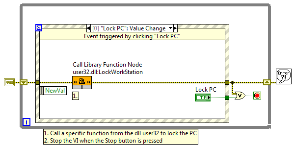

This VI shows how to lock a windows workstation programmatically
2. Description
This example VI calls the function LockWorkstation from the Microsoft Windows' dynamic link library (DLL) User32 whenever a boolean control is activated.
3. Requirements
  • NI LabVIEW Base Development System 2012 or compatible.
4. Steps to Implement or Execute Code
  1. Download, open, and run the VI.
  2. Click the "Lock PC" button to trigger the event structure that executes the Call Library Function Node, to lock your PC.
  3. Unlock your PC (you will need to enter your password if you have configured one).
  4. Click the Stop button when you are done testing the VI.

Lock PC programmatically Screenshot.PNGLock PC programmatically Screenshot.PNG
