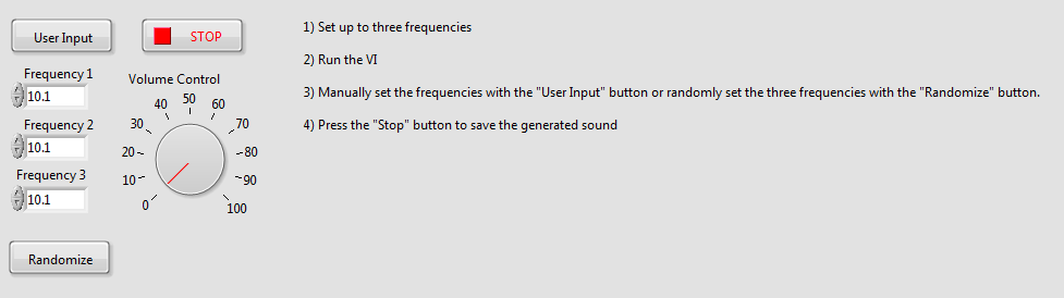

This example allows the user to set up to three frequencies or randomly choose three frequencies. The sound file is then saved as .wav file.
Description
This code establishes a sound task that takes up to three frequencies and plays them simultaneously. The user is able to dynamically change the frequencies and volume and the sound output is saved in a file titled RandomSoundGenerator.wav .

  1. Download and Open VI
  2. Set up to three frequencies
  3. Run the VI
  4. Manually set the frequencies with the "User Input" button or randomly set the three frequencies with the "Randomize" button.
  5. Press the "Stop" button to save the generated sound

Front panel
