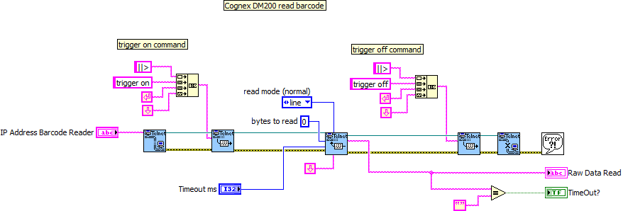

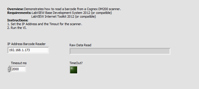

This example demonstrates how to open a connection to a Cognex DM200 scanner, initiate a read request and wait for the read data string.
Description
This example shows a way to use a Cognex DM200 scanner with LabVIEW. It is very basic and use only the commands Trigger ON and Off.
This example uses the LabVIEW Internet Toolkit to communicate with the scanner over Telnet. The Internet Toolkit is deprecated as of LabVIEW 2012 and is no longer shipped. You must replace the Telnet VIs with pure TCP/IP VIs if you want to use this example with the latest version of LabVIEW.

  1. Download and open the attached VI
  2. Run the program

please can you convert this to an older Version 8.6 or give a print/ picture of the block diagram?
Thanks a lot and best regards
George
Brooks.Nelson
Member
Member
on
Is there a way I could get the internet toolkit with the telnet, so I can load this vi?  I downloaded 2012 but the toolkit was not there.
