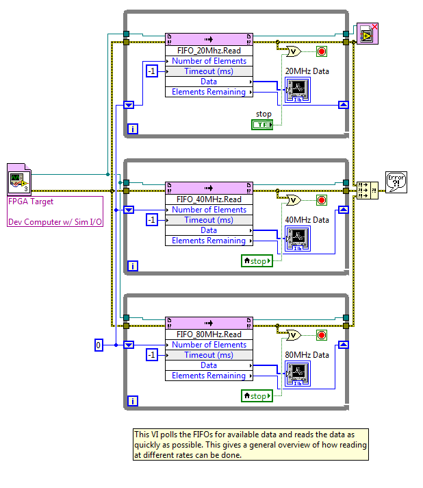

This Project shows you how to sample multiple channels at different rates and log the data to charts on the Host VI's Front Panel
Host VI FPGA VI
The projects are uploaded in both LV 2011 and LV 8.6
