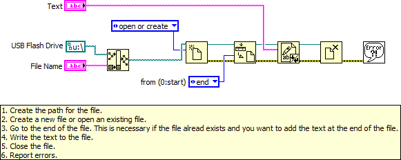

This VI demonstrates how to write a string into a textfile and save that file to a USB Flash drive connected to a cRIO.
Description
Some cRIOs/sbRIOs offer an USB port which can be used to connect a USB Flash drive or other storage devices to the cRIO. This example shows how to use the USB Flash drive in LabVIEW. Additional information are available in the KnowlegeBase Writing to an External USB Drive or SD Card from a LabVIEW Real-Time Device.

  1. Download and open the attached ZIP-file
  2. Open the [Main] ...VI and follow the instructions on the Front Panel
