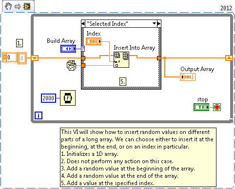

Coding that exemplifies how to insert data into different parts of a given array.
Description
This code consist on inserting a random number into an array depending on what the user chooses. Within the options the user has, we can select either to insert a value at the beggining , the end, or at any specific index.
Requirements
LabVIEW 2012 (or compatible)
1. Open the "Insert Data Into Array-LV2012 NI Verified.vi"
2. Select the Run button.
3. Choose any options fro the User Control
4. Observe the Output Array indicator being updated
