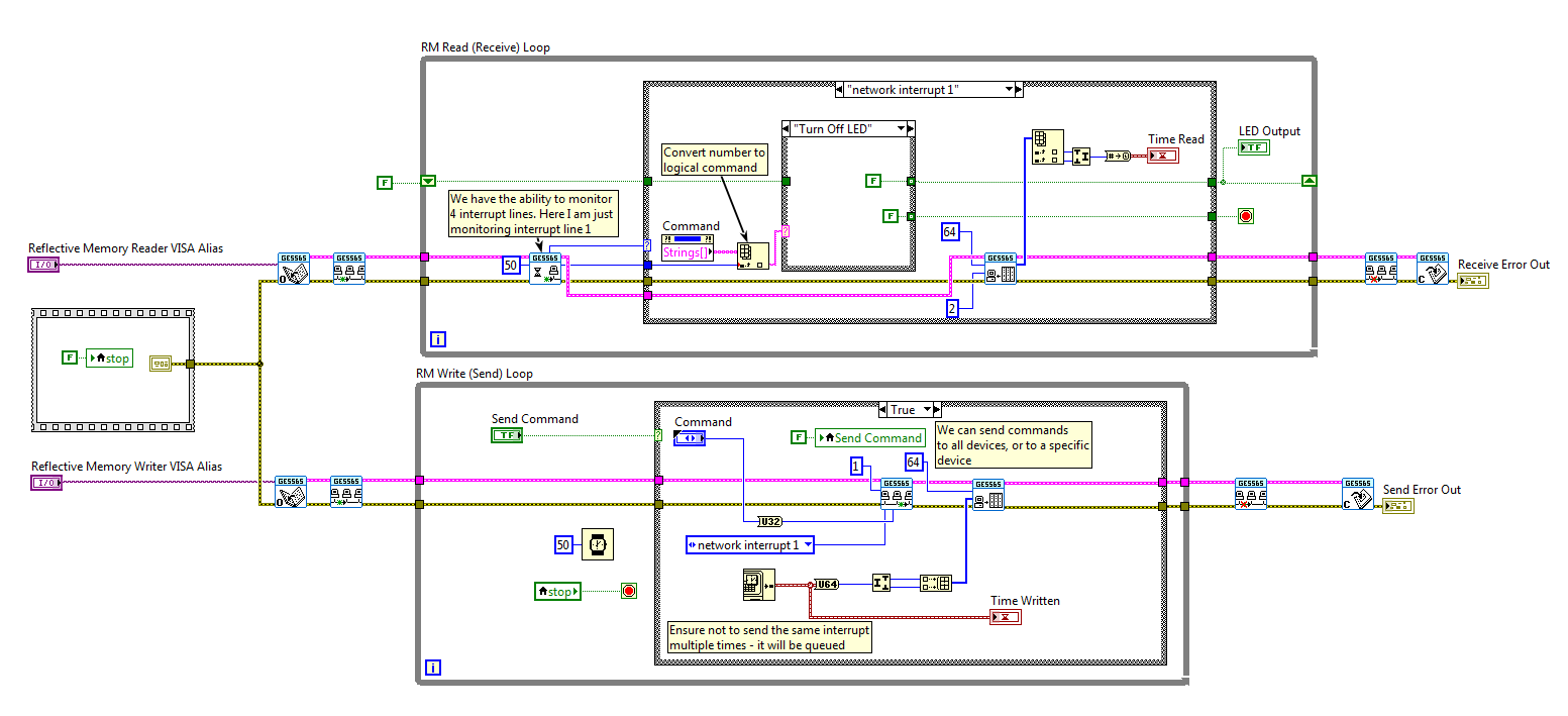

The example is written for a single PXI chassis with two reflective memory modules. This example can be extended to multiple PXI chasses by separating the read and write loops and executing them on separate chasses.
The user is able to select from a number of commands: Turn on LED, Turn off LED, and Stop. Once a command is selected, the user clicks the Send Command button to send the network interrupt. The example uses network interrupt line 1 (there are 4 to chose from), and sends the interrupt directly to device 1. The device number is set in hardware. Information on the procedure to set the device number can be found in the 5565 manual. The reader reflective memory card continually polls the network for an event using the Wait for Event VI. Once an interrupt is detected, the read loop decodes the command back to a String representation of the command, and executes the desired action. An additional feature is that the example writes the time that the network interrupt was sent to a reflective memory address, and when the network interrupt is received, the time is read back. This could be extended to benchmark the time difference between the writes and reads.
